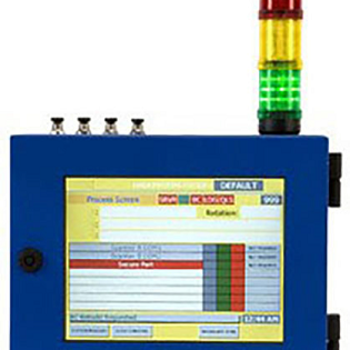

In another example, a large engine manufacturer has a self-contained equipment health monitoring MES. Its rate of tool failure was creating unacceptable levels of downtime and scrap. A system was developed to collect usage data from each individual tool and define maximum tool life. A line-side human-machine interface (HMI) was provided to allow the tool's anticipated life to be viewed by operators. Today, when a tool approaches 90 percent of its maximum expected life, the system alarms, notifying the operator and the maintenance staff. As a result, not only have downtime and scrap decreased, but the overall cost of tools is lower because purchasing can identify and buy the tools that last the longest.
Figure 1: Example of line-side MES HMI

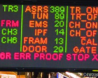

Once equipment health monitoring systems are in place, an expanded MES can identify and prevent bottlenecks, guide overall process design and facilitate line changes. For example, a plant wanted to increase its line speed from 17 jobs per hour (JPH) to 23 JPH. The plant used its MES to understand operator cycle times by shift. One of its shifts had limited over cycles, while another shift had a much larger occurrence of over cycles. Was there a variation in training, or a lack of parts? Or, if both shifts were identical in those aspects, was there a process issue at fault? The MES allowed the industrial engineering team to determine whether an operator or process issue was the root cause, correct it and bring line speed up to the target of 23 JPH.
Figure 2: Equipment health can be broadcasted plant-wide
Plants running multiple assembly lines can use data from one line to prevent problems in another. When an equipment issue is creating problems on Line A, maintenance staff can take action to prevent the issue from occurring on Line B. When a new process or machine is added to multiple lines, the MES can compare and contrast equipment health on each line to quickly head off problems across all lines.
