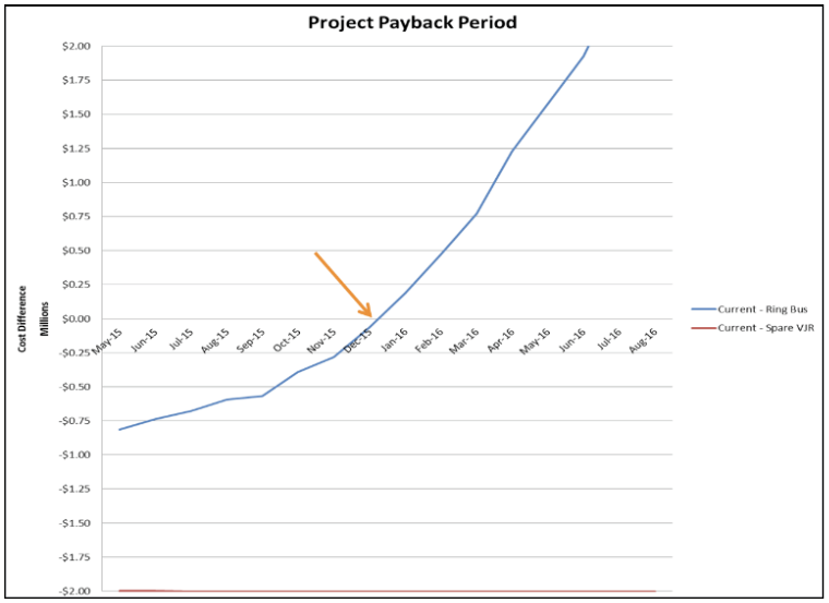

So, rather than simply considering the capital costs of purchase and installation, the team used Monte Carlo simulation to look beyond the capital investment and consider the total cost of ownership for five years and eight months, the period before selling off the farm to another utility. Running one thousand simulations over the twenty-year period, the results were obvious to those funding the project with a payback of eight months. When the recommended design was presented, the technician stated, “Oh, I hadn’t thought about risk reduction and cost avoidance, this makes a lot of sense.”
The greatest value was in being able to use data, monetize the risks, and model system behaviors to demonstrate the total lifecycle cost associated with various designs. Once able to tell this story, people joined the reliability engineer and designers and the project was completed with the ring bus.
