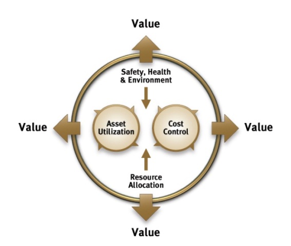

This acquisition required Volvo Cars Gent to align with the Ford Production System (FPS). After thorough analysis and benchmarking different Ford plants, it appeared quite quickly that Volvo Cars Gent had a big lead in different manufacturing techniques. But there was one big problem: the Volvo approach was not uniform within different establishments of Volvo Cars. The Volvo Cars Manufacturing System (VCMS) was created to make the Volvo approach identical throughout Volvo Cars. The responsibility of this initiative was to collect best practices and roll them out uniformly. Mainnovation, which created the Value Driven Maintenance® (VDM) methodology, supported Volvo Cars in shaping VCMS maintenance. VDM was used as a central model to collect all best practices from the different Volvo manufacturing factories and make them uniform. Based on these best practices, a common maintenance process was established, maintenance tools were introduced and training was initiated. Creating added value with maintenance was getting more and more important as time progressed. This model was used continuously to determine whether the dominant value driver should be availability or costs. The processes, IT tools, data and maintenance performance indicators were refined and adjusted to Volvo’s needs.

Figure 2: The four value drivers of the VDM model.
A crucial adjustment was made in the maintenance organization. The decentralized maintenance organization was completely integrated into production during the TPM period, but it appeared to be too expensive and the exchange of experience within the overall organization was labor-intensive. Most companies have cycles of centralizing and decentralizing the maintenance organization where they usually embrace either extreme. But Volvo Cars Gent didn’t make this mistake and chose a hybrid maintenance organization. The “own maintenance activities” (maintenance executed by production operators) and corrective maintenance stayed within the production organization. All remaining maintenance was centralized into a governing maintenance department. This department is responsible for all preventive maintenance activities, modifications and long-term asset management. I was responsible for leading this department and am a permanent member of the plant management team.
