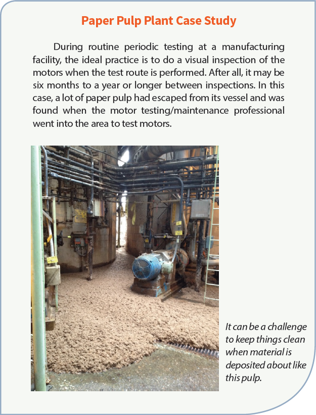

There are many examples of how keeping equipment clean can provide great reliability benefits. Electrical circuits are designed with specific insulation thickness across coils, phase conductors, inside relays, circuit boards, etc. One element that is important for these applications is the concept of electrical leakage and/or tracking. Electricity, analogous to water, always seeks the path of least resistance in any circuit. When there is an insulation system keeping the electrical current flowing where it should be, there is always a certain electrical stress. The electrical stress is across insulated conductors and through cracks, flaws, thin points in insulation, or circuit areas where inadequate clearance exists. This stress forces the current to flow across, over surfaces, or through the electrical insulation. A circuit board in electronic equipment may become extremely heavily packed with dust, hair, or foreign particles and these items deposit on electrified surfaces. The result is a protective system breakdown and failure. Coils and cooling passages in a motor may be plugged with debris. A major culprit is the operation of cooling fans. When filters are inadequate or not present, they can pull large amounts of material right into the interior spaces. Result = In Service Failure.

Wind-driven water or torrential rain by tropical conditions can be forced through seals. Processes, such as pulp and paper production, generate a lot of wet pulp and other by-products. These can penetrate connection boxes and conduits, be sprayed about by shaft mounted fans, or achieve ingress via weakened or worn seals. The net result is water gets inside and stays inside, especially when drain plugs are clogged by debris.
