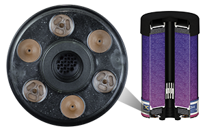

Some of the more challenging environments to operate equipment involve constant high humidity or washdown areas. The need to consistently clean equipment in a food processing facility or being in a naturally high-humidity environment like a paper mill requires additional considerations to protect equipment.
In these environments, using a desiccant breather with internal check valves create a sealed system that "breathes" only when necessary-reducing the frequency of breather replacements.
