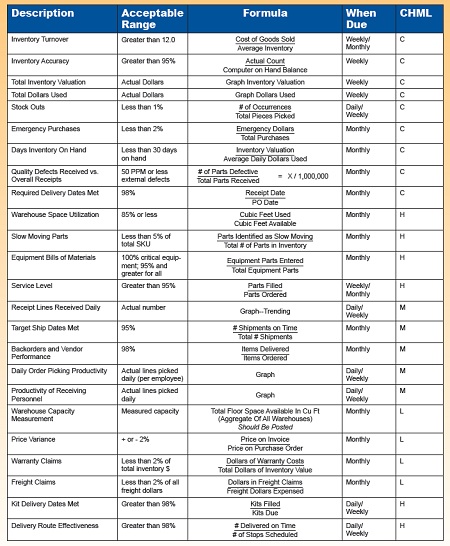

Quantitative Measurements Matrix Chart
Listed are the required formulas and descriptions of each KPI for Stores and MRO. The maintenance manager must rank the importance of each KPI to his or her needs. They are ranked in four categories: C-Critical need, H-High importance, M-Moderate need, and L-Low importance. Performance can then be benchmarked and compared.

The quantitative measurements matrix chart (on the previous page) presents the required formulas and gives a description of each KPI for Stores and MRO. The maintenance manager must rank the importance of each KPI to his needs. They are ranked in four categories: C-Critical need, H-High importance, M-Moderate need, and L-Low importance. Performance can then be benchmarked and compared.
