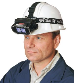

Westbury, New York — A proactive maintenance protocol can reduce expensive equipment failures and the loss of production they cost. But finding little leaks before they turn into big problems is a time consuming, hands-on job. Not anymore. The Spectroline® EagleEye™ UV/White Light LED Leak Detection Lamp Kit (EK-365) is the hands-free solution to locating leaks in cramped or hard-to-reach areas larger lamps can’t…because the EagleEye is wearable technology made simple.
This unique kit features a palm-sized (L 3.75 in. [9.5 cm.] x W 2.25 in. [5.7 cm.] x H 1.85 [4.7 cm.]),lightweight (8 oz./ 227 g.), cool-running, versatile lamp. It can be worn on a hard hat (not included), or directly on the head. It can also be hand-held with the attached lanyard. It has two ultra-high intensity UV LEDs for fluorescent leak detection—plus with just a flip of the switch—a three-LED white light assembly for illuminating dark work areas. With power comparable to high-intensity 100-watt lamps, the EagleEye runs on a rechargeable lithium-ion battery that provides up to 75 minutes of continuous inspection between charges. It features an inspection range of up to 12 feet (3.6 m.) and a 100,000-hour LED service life. Its built-in fan keeps the lamp cool
