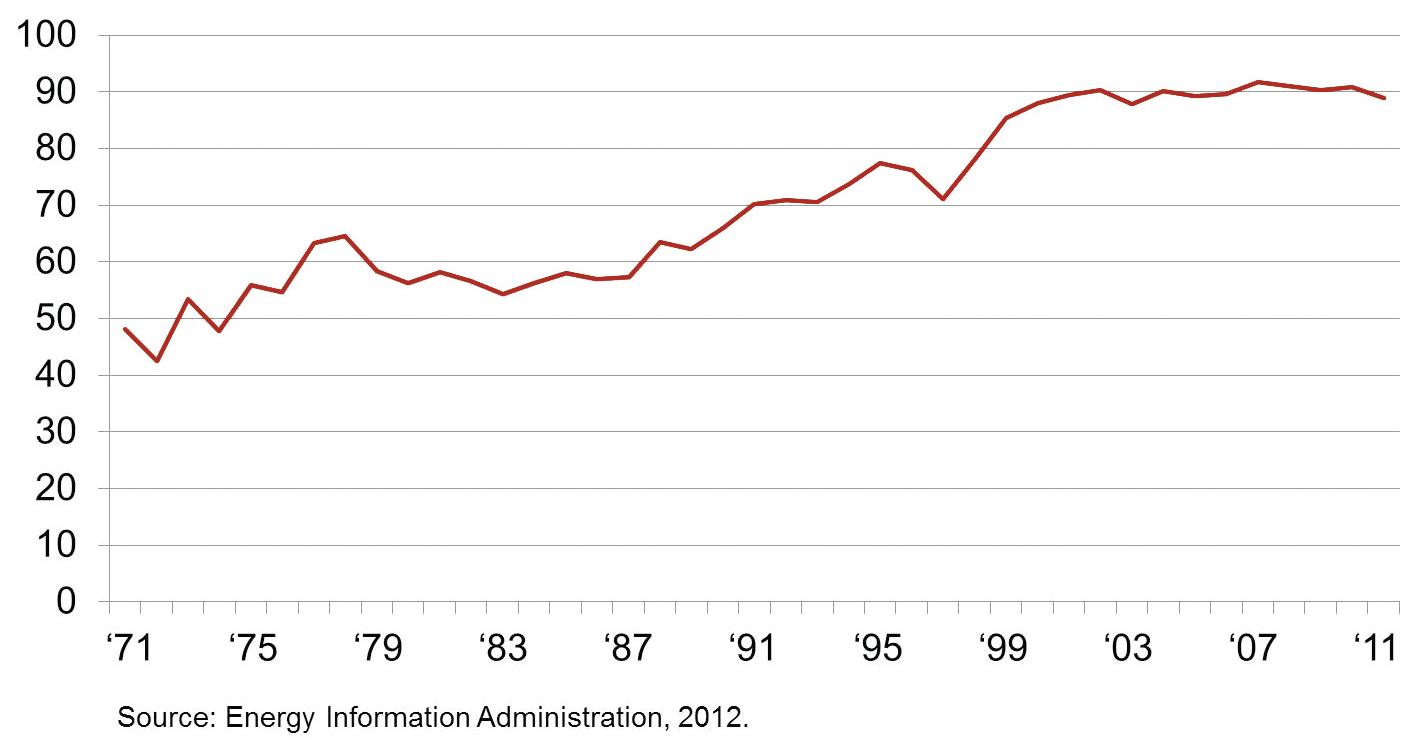

They are now the most productive, the most reliable and the safest they have ever been:
  • U.S. nuclear power capacity factor has gone from 48 percent in 1971 to an average of 90 percent over the past decade.1

U.S. Nuclear Industry Capacity Factor 1971-2011
