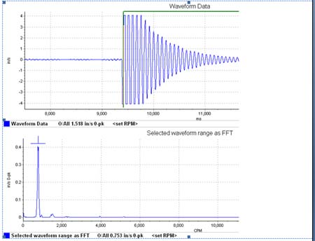

A screen shot of captured long time waveform data over a 20-second interval is shown below.
commtest fig 1commtest fig 1
commtest fig 2commtest fig 2
In selecting just one good ring-down effect of the bump in time and converting it to frequency will pinpoint the natural frequency, 765 CPM in this case.
