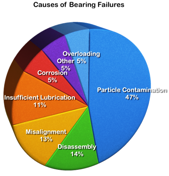

So how much of this is due to lubrication? Since a large percentage of assets in a plant are rotating or reciprocating, I would argue a lot! But don’t take my word for it. SKF has published a number of articles on the effect of lubrication on bearing life (Figure 1) that seek to answer this very question. Based on SKF’s data, we can conclude that, in a general sense, poor lubrication as defined by the impact of particle contamination, water contamination (corrosion) and inadequate lubrication equates to as much as 63 percent of all bearings failures.

Figure 1: Factors that affect premature bearing failure
