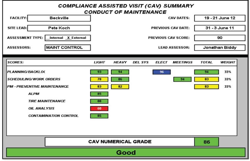

Figure 1: Site equipment and reporting grade
Figure 2: Heavy equipment dragline grade

  • Maintenance-Compliance Assisted Visit (M-CAV)
    • Yearly site assessments;
    • Review scoring, planning, scheduling and Preventive Maintenance (PM) optimization (RCM courtesy);
    • CAV measurements;
    • Corrective Action Process;
    • Corrective Action Program (CAP) overview – Closeouts identify Corrective Actions (CAs) and owners and are then posted on Safety Tracking Program (STP) site for weekly review with a status of M-CAV;
    • Year-end updates – For each section review, bring Systems Maintenance Engineer (SME) all questions for scoring, validity and improvements; communicate changes to sites;
