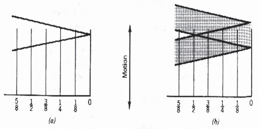

In all calibration using sinusoidal motion (oscilloscope), be sure your shaker’s acceleration waveforms are sinusoidal. Otherwise, errors can result.
RELATIVELY CRUDE CHECKS
Consider the veescope shown in Figure 2. Place one on the armature of your shaker. Attach your accelerometer. “Eyeball” the wedge while adjusting shaker displacement (frequency previously set at 44.2 Hz) to peak-to-peak D=0.1 inch. Calculating A=0.0511f2D shows that you are shaking at A=10g. Alternately, use D=2.5 mm at 44.5 Hz and calculate A=0.00202f2D=10g.
Divide the electrical output (value) from your accelerometer/signal conditioner by 10 to get sensitivity in pC/g or mv/g.
