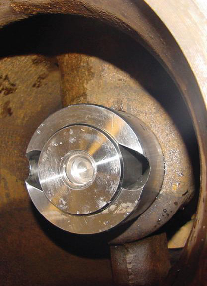

A new mid-size refinery in the Middle East required parallel running of main condensate feed pumps (2x100%) during the commissioning phase to meet plant throughput, instead of having one on standby. The reason being that the motors driving the centrifugal pumps were getting tripped on high current overload when run individually at the designed throughput capacity. Running the plant on a single feed pump accounted for a 20 percent reduction in production. An early investigation by the project commissioning team and pump OEM recommendations (in absence of a reliability program) did not reveal the actual cause of the problem. Due to production pressures, it was mutually agreed to run both pumps in parallel to achieve the production targets until the problem was fixed. Both pumps ran in parallel for four years until a reliability section was established in the organization and conducted an investigation on parallel running pumps. The performance testing and design review of both pumps showed nothing significant. A second performance test was conducted to evalute the performance of automatic recirculation valves (ARVs) installed in the discharge lines of the pumps. It revealed extensive recycle flow across the ARVs, eventually shifting the system performance curve and causing the motors to trip at overload when run individually.

Figure 1: ARV brought to workshop for overhaul
Part 1Part 1
Figure 2: A seized ARV bypass valve
The ARVs were overhauled during the next available shutdown and both were observed to have seized slide valves, allowing full flow bypass across the ARVs since commissioning. This raised questions regarding the execution of ARVs’ functionality checks prior to installation, as per vendor recommendations. After servicing, they were put back into operation and worked satisfactorily. Since then, one pump is now on standby.
Lifecycle cost savings of $800,000 was achieved by this defect elimination. The estimated production loss in the past four years due to the occasional downtime of one pump was estimated to be $350,000.
Similar problems were resolved on eight other pumps (with ARVs) that were running in parallel since commissioning with no standby, thereby saving millions in LCC costs in comparison to keeping them running in parallel for the lifecycle.
