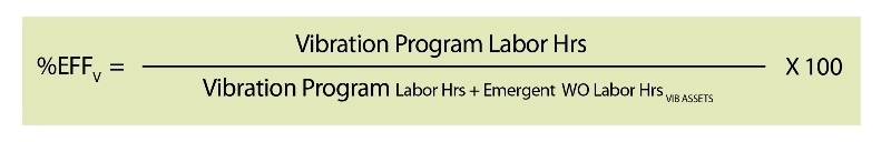

So how do we successfully communicate to our management team the value of our vibration analysis program? The approach described below is one that uses the functionality of a computerized maintenance management system (CMMS) to identify the impact our program has on the utilization of resources in a reactive maintenance mode. In order to accomplish this, we must ensure the work order and asset modules of our CMMS are properly configured with specific attributes that can be queried to help identify assets included in the vibration analysis program, corrective work types, emergent/breakdown work, labor and material costs, and lost production costs. In doing so, our CMMS provides the ability to query all emergent work orders and filter on those assets that are monitored within the scope of the vibration analysis program for a given date range. Additionally, fault codes can be utilized within the CMMS to provide more granularity in the identification of vibration related anomalies as opposed to the more general blanket of emergent work cast over the assets within the program scope.
Query results displaying totals for labor hours on repair work orders are then used in the calculation that follows to determine the effectiveness of a vibration analysis program in reducing reactive maintenance activities.
equationequation
For example:
In the month of December, we spent a total of 80 man-hours on data collection, analysis and reporting. During that same time period, the plant experienced 10 anomalies out of the 250 machines we routinely monitor during the month that either resulted in a breakdown or emergent repairs. The 10 anomalies resulted in a total of 100 man-hours to reactively repair and restore affected equipment to normal operation. The vibration monitoring program’s effectiveness based on labor utilization can be calculated as:
Trending vibration program effectiveness on a monthly basis provides a focused performance measure that gives greater insight into the traditional percent reactive work key performance indicator (KPI) used to indicate the general mode of maintenance efforts. Deeper analysis of specific contributors to the effectiveness of the vibration analysis program can help identify areas for improvement and implement targeted corrective actions that will enhance existing maintenance strategies for our rotating equipment.
