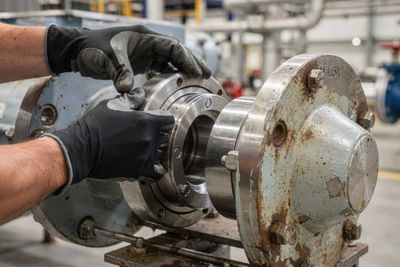

Mechanical seals are often small compared with the pump, driver, coupling, baseplate, piping system, or control system. Yet anyone who has spent time around rotating equipment knows that seals can have a much larger impact than their size suggests. A mechanical seal is not just a wear part. It is a containment device, a reliability component, an emissions-control device, and in many services, a critical safety barrier. At its simplest, a mechanical seal contains process fluid where a rotating shaft passes through a stationary casing. In real plant operation, that simple function becomes extremely important. A seal may be the only component preventing a hydrocarbon, toxic fluid, hot liquid, corrosive chemical, or environmentally sensitive product from leaking to atmosphere. When a seal performs well, it is easy to forget it exists. When it fails, the consequences can include unplanned maintenance, environmental release, equipment damage, production loss, personnel exposure, and in some services, fire or safety risk.
Seals are also not inexpensive components. A wet seal repair can cost approximately $30,000 to $70,000 per cartridge depending on the design, materials, failure mode, and type of seal. Specialized dry gas seal repairs can exceed $100,000 per repair. New seal designs can cost even more depending on the application, pressure, temperature, service, emissions requirements, and engineering involved. Plants may also need to carry spare cartridges for critical equipment, adding further inventory cost. When repeated failures occur, the lifecycle cost can quickly move beyond the seal itself and include downtime, troubleshooting, lost production, emergency maintenance, and environmental response.
For this reason, seal reliability should not be treated as only a maintenance issue. It directly affects equipment availability, operating risk, and lifecycle cost. A seal failure may appear to be a localized pump problem, but in many cases it is a symptom of a larger system issue. A mechanical seal works through the interaction of two highly finished faces. One face rotates with the shaft, while the other remains stationary with the seal gland or housing. These faces are pushed together by spring force and hydraulic closing force from the sealed fluid. The faces are manufactured to a very high degree of flatness, and the gap between them during operation is extremely small.
The important point is that most wet mechanical seals are not intended to run completely dry. Reliable operation depends on maintaining a very thin, stable fluid film between the rotating and stationary faces. This film provides lubrication, removes heat, and helps prevent destructive face contact. In many ways, the fluid film is the heart of the seal. The challenge is that the film must be thin enough to control leakage, but stable enough to lubricate and cool the faces. If that film is disturbed by flashing, vaporization, solids, contamination, coking, poor cooling, or unstable pressure, the faces can overheat, wear, distort, crack, blister, coke, or fail. This is why simply replacing a failed seal cartridge without understanding the operating environment often leads to repeated failures.
