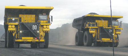

Some in the industry say real-time strut data and payload readings are not necessary to maintain haul roads, and as Figure 1 shows, they are correct. I would argue, however, that the benefit of strut data and payload readings is their value as informational tools that enable the operations foreman to effectively prioritize and dispatch road crews to strategically tackle daily road repairs.
Figure 1: Example of a haul road
