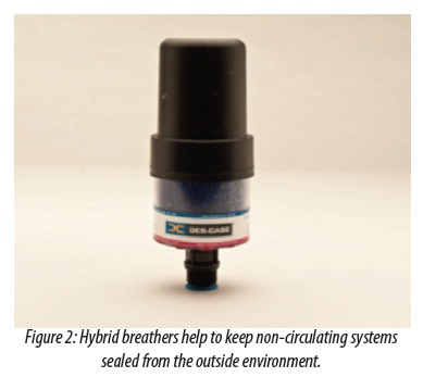

In industries where severe levels of water or humidity are present, the use of hybrid breathers are recommended on any non-circulating system. This type of breather includes an expansion chamber, which serves to keep the machine sealed from the outside environment, while allowing for volumetric changes due to fluctuations in operating and ambient temperature (Figure 2).
Uptime Article Fig 2Uptime Article Fig 2
