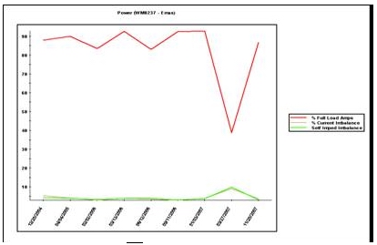

Take the following example for instance: During routine testing, a 125 HP pump motor indicated a current imbalance of 8.56% and an impedance imbalance of 13% (see figure 1). Normally a current imbalance of this nature is cause for concern and is an indication that there is a potential winding fault. But, a motor that is not sufficiently loaded will possibly run with a current imbalance. This creates variations in the phase impedance, which duplicates indications of a stator fault. In the case of this motor, it was only loaded at 41% Full Load Amps. When it was observed that the loading was inadequate to produce repeatable data, (that could be reliably trended), an additional test was scheduled to confirm motor condition.
Table 1Table 1
The results of the follow up test confirmed the Analysts suspicion that the data taken when the motor was insufficiently loaded was not adequate to make a recommendation for further offline testing or a recommendation to replace the motor outright (see figure 2). It is important to keep in mind that the repeatability of data taken is one of the most critical issues facing any application of Condition Monitoring technology and directly affects the ability of the applied technology to accurately classify defects. In the case of Online Motor Circuit Analysis, noting drive train load is critical to accurate fault detection.
