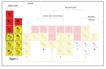

The Synchronous Group
The synchronous grouping in Figure 2 includes faults that generate a predominant 1x rpm response in the spectrum. There are many faults that fall into this category, including some faults that may start as a synchronous fault and, if left unchecked, may deteriorate into another group.
For our purposes, the synchronous faults start with an elevated 1x rpm response and hold this pattern (save increasing amplitudes). The synchronous group is a small select group that is narrowly defined in the first column on the table. This group includes unbalance, eccentricity, mechanical looseness type A, gear tooth faults and belt drive misalignment problems.
The second column is also representative of synchronous response, but often may include an additional harmonic as well as the 1x rpm peak. This effect can be related to the severity of the fault and may change with overall fatigue in the machine. However, we will see that some of the other categories will also, on occasion, overlap into adjacent groupings.
