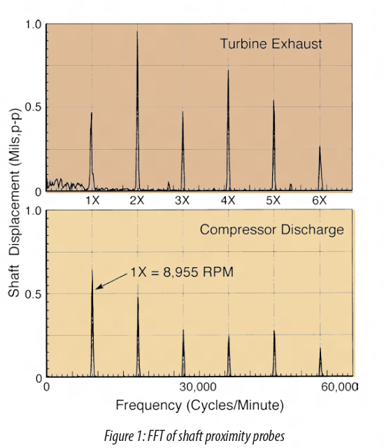

Bearing temperature increased to 215 F during the warmth of the next day. At this point, concern began to develop about the longevity of this bearing. Various inspections and examinations were performed with inconclusive results. In an effort to understand the shaft vibration, plant personnel employed a spectrum analyzer to produce FFT plots of the proximity probes. A typical set of spectrum plots across the coupling are shown in Figure 1.
FFT data from the Y-axis proximity probe at the turbine exhaust and the coupling end compressor bearing are displayed in Figure 1. Note that both spectrum plots reveal acceptable amplitudes at 1x rotational speed, plus a string of running speed harmonics (i.e., 2x, 3x, 4x, etc.). On the turbine exhaust, the amplitude of the second harmonic was twice as large as the fundamental 1x component. This vibration data was of concern to the plant personnel and two different opinions were soon openly debated.
Some people were convinced that the series of multiple harmonics were due to mechanical looseness of the turbine bearing. Others had the opinion that the vibratory behavior was due to misalignment across the gear coupling. One proposed solution was to monitor vibration as the compressor's hold down bolts were loosened and the compressor was allowed to move into a state of satisfactory hot alignment. For the uninitiated, it must be recognized that this type of action is extraordinarily dangerous. There is massive energy contained in an 800-pound rotor rotating at 8,955 RPM. The danger of releasing that energy by unloosening the hold down bolts is obvious and is not justifiable. Fortunately, this activity was not implemented and it was agreed to just continue monitoring the machinery.
Both theories were downgraded following several days of operation. Each day, shaft vibration amplitudes remained constant and the turbine exhaust bearing temperature cycled between 210 F and 215 F. Clearly, if the turbine bearing was loose, the behavior would tend to degenerate with time and that did not occur. The misalignment theory was also discounted. Specifically, if heat generation in a bearing was due to misalignment, it is logical to believe that the bearing would either fail or relieve some clearance due to the applied preloads. It is hard to believe that any significant misalignment would appear as constant vibration and elevated temperature without any change. Furthermore, the maintenance work performed during the previous turnaround did not disturb the coupling alignment. At this time, it was necessary to examine the machinery behavior in more detail to resolve this problem.
