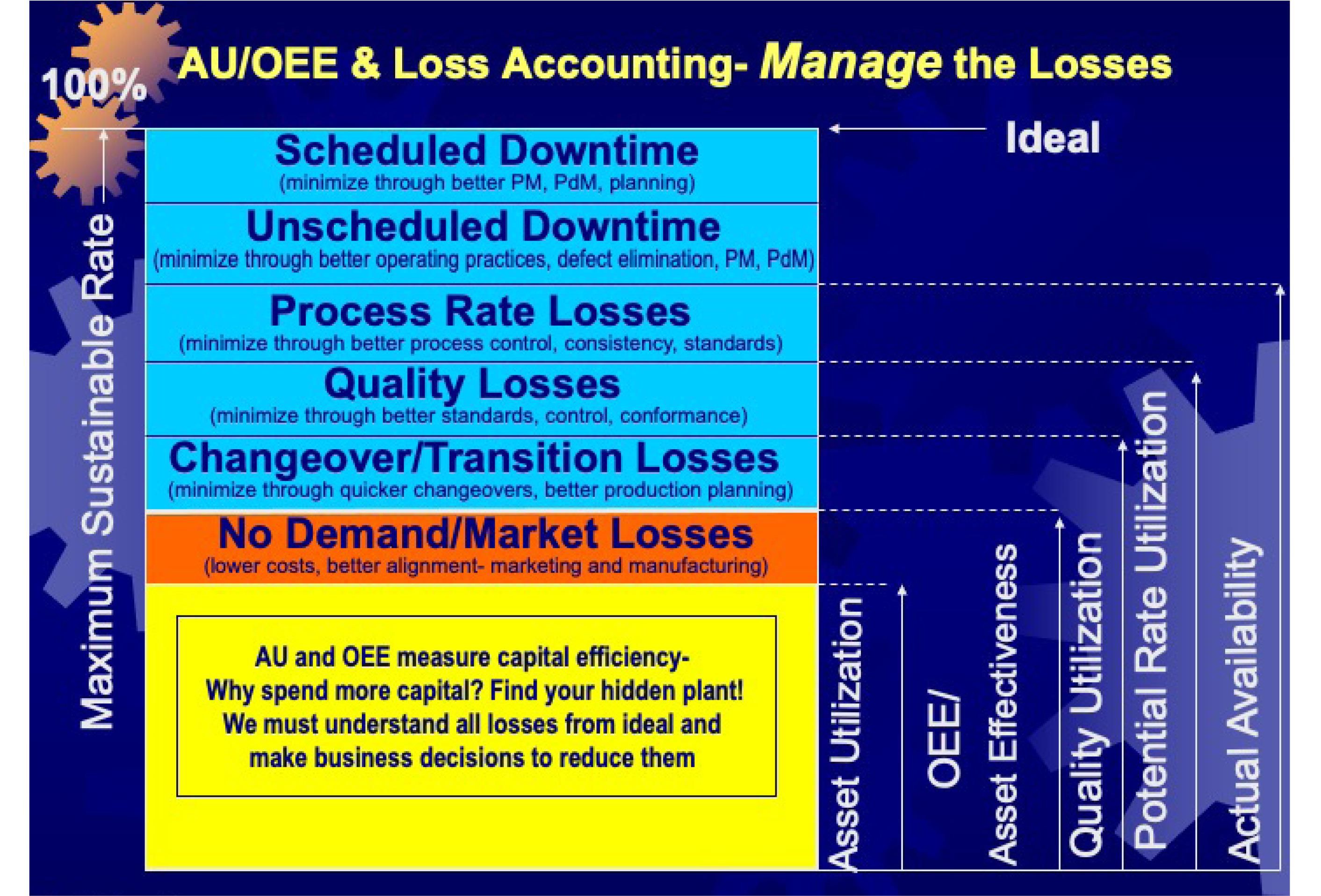

Fundamentally, it takes the form: OEE = A x R x Q, where A is availability percentage, R is production rate percentage and Q is quality percentage.
Figure 1 provides one model for OEE. It contains the usual categories for an OEE measure – availability, rate and quality. However, it also adds transition and changeover losses, something that might be omitted in a conventional measure, along with an additional loss related to no demand and market losses. Some businesses may want to include other loss categories specific to their business, such as raw material supply, utility disruptions, operator no-shows, etc.
Figure 1: A model for OEE measurement
The losses shown in blue in Figure 1 are more typical in an OEE measure, the losses shown in orange are not. The distinction made is that measuring all losses from ideal provides a measure of the business’s asset utilization (AU) and includes no demand. The plant is responsible for the losses in blue, the business is responsible for all losses, including no demand. In this light, AU is a measure of the capital efficiency of the business, not just the production efficiency of the plant. It provides an indication of the additional capacity available to the business that does not require additional capital investment. In this light, it is essential that you measure ALL losses for a given production operation – 8,760 hours in a typical year.
This runs contrary to Nakajima’s recommendation to measure losses only during planned production time, which is an acceptable approach, but doesn’t provide a total business perspective. An important point here is that you will never achieve the ideal state or zero losses, but the key is to manage the losses to make business decisions about whether the losses are acceptable or not.
Fundamentally, if you apply the model in Figure 1, you would answer several questions – if you could run your plant 8,760 hours per year at 100% of your maximum, demonstrated, sustainable rate, at 100% first pass, first quality yield, with no losses for changeovers or transitions, and no demand losses:

The most important question here is clearly number four – Are these losses acceptable to the business? You will always have losses from ideal, but you must sort through the data and manage the losses. Some will be acceptable, like time for highly efficient product changeovers or planned maintenance, some will not. Some will require more investment than is required for an acceptable return, some will be long term, like market demand and so on. Things that are easier to do and have a high return will get done first; things that are hard to do, but have a high return will be longer term, with everything else in between. Of course, things that are hard to do and have a low return will be acceptable for now. As time passes and you learn more about managing the losses, or as new technology becomes available, you may revisit those.
