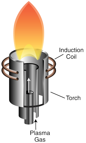

The cornerstone of nearly all routine oil testing is atomic emission spectroscopy (AES), commonly referred to as metals testing. AES is the test that provides data to us, in parts per million (ppm), related to wear metals, lubricant additive metals and contaminant metals.
There are two common types of AES performed in oil analysis laboratories: inductively coupled plasma (ICP), as shown in Figure 1, and rotating disc electrode (RTD), arc spark, rotrode, as shown in Figure 2.
Figure 1Figure 1
Figure 1: Inductively coupled plasma energy source
