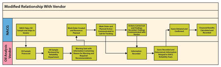

The solution was simple, though the success of it was greatly slowed due to resistance within. We requested that the sampling lab take on greater responsibility for the overall interpretation of the oil analysis results, which increased the level of service they could now offer. They would then send the information to the site specific personnel and hold them accountable for any actions taken or not taken, as seen in Figure 2.

It was to be a partnership more than the vendor type relationship the two companies had previous to the project, paving the way for a higher level of expectations. A timeline was given and it was reiterated that if financial benefits were not achieved during that time, the services of the oil analysis lab would no longer be required.
