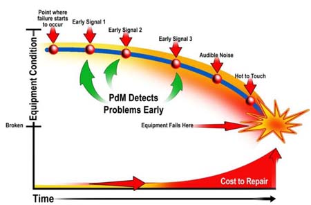

ELEMENT 1 - Focus on Abnormalities, not Failures: Point "P" (the onset of failure) differs greatly from point "F" (the loss of function) on the P-F curve. Many operators do not understand this relationship and are not conditioned to report equipment abnormalities.
With simple discussion, this important differentiation can be explained. It is important to continually discuss the different ways in which abnormalities present themselves on the equipment under each operator's care, and to train them in the common failure modes that they must be looking for.
Fig 2Fig 2
The P-F Curve
