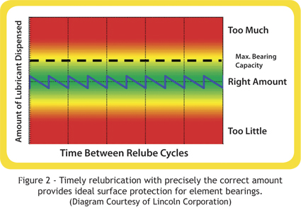

Either too much/too little grease, and/or inappropriately high/low oil viscosity causes viscous drag and/or destruction of the bearing surfaces and lubricant within the bearing.
In moderate and high speed bearings (nDm > 150K), even slight variations in consistency of replenishment and fill volume produces effects including dry surfaces and elevated high-frequency vibration (inadequate feed), elevated temperatures and increased energy consumption (overfeed).  The faster the shaft speed, the more pronounced the deficiencies.  As the shaft speed decreases the negative impact (churning, overheating, and energy losses) declines, but is still evident.  The first part of this multi-part article addresses lubricant viscosity selection.  The second part addresses volume and frequency.
