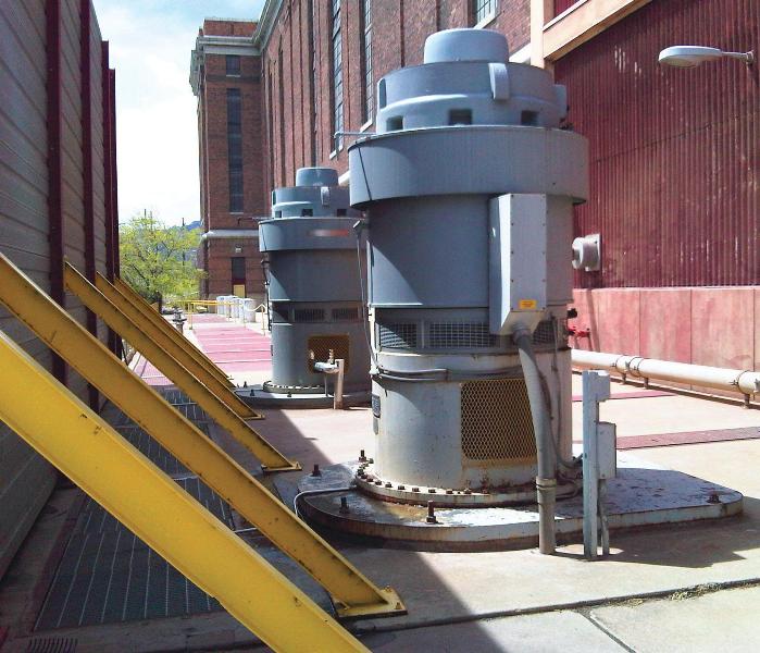

Figure 2: In-service pump motors in Boulder, CO

If it is your job to ensure plant maintenance or motor quality, you know you need to test. So how can you traverse the many pitfalls? Sharing of information is paramount to the success of your testing or predictive maintenance program. Before any testing is done, make sure each individual involved is versed in the goal of testing and understand the repercussions of that goal. In a nutshell, the goal of the electrical testing is to identify “bad apples” and repair or remove them from the process – preventing or mitigating the effects of an in-service failure.

From a motor shop doing the testing to upper management that is signing off on the contract for testing, everyone needs to fully understand. Full disclosure and review of the testing history, including test reports (if available) of past problems, such as cables, gear box and bearing issues, or motor stalling/tripping problems, need to be discussed. If testing reports are unavailable or have not been kept, the best course of action is to obtain a baseline of motor testing. A battery of tests can be performed at appropriate levels that will provide valuable information on each without decreasing any remaining life in the motors. Once a baseline is established, further testing can be done to find potentially failing motors.
Another discussion prior to testing is to ensure that all testing standards have been reviewed and are fully understood. These IEEE standards include, but are not limited to, IEEE 43, IEEE 95, IEEE 112, IEEE 118, IEEE 522 and IEEE 1415. These testing standards, established by the Institute of Electrical and Electronics Engineers, give a good framework to testing and offer the basis for moving forward in an effective manner. Once there is a general understanding of the goals and processes, guidelines for testing can be developed for all parties involved.
