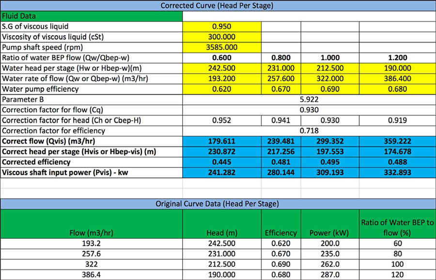

Consider the case of an API 610 between bearings two-stage centrifugal pump that has been performance tested on water and the performance curves subsequently provided by the vendor. These curves can be recreated in a spreadsheet at various flow points, however for this article, the curve is analyzed at 60, 80, 100 and 120 percent of the rated best efficiency flow. Assuming the test conditions to be at 20 degrees C, with the viscosity of distilled water 1.005 cSt and the revolutions per minute (rpm) set at 3,585 for the original curve (see Figures 1 and 2, and Table 1), the spreadsheet can be then customized to correct the pump performance if the pump were to pump castor oil with a viscosity of 300 cSt and a specific gravity of 0.95.
The Hydraulic Institute recommends calculating the parameter (B) based on the water performance best efficiency flow (QBEP-W) as follows:
(Where Vvis is viscosity of the new liquid, HBEP-W is water head at BEP, QBEP is water flow at BEP and N is the rpm of the pump)
Table 1: Calculations developed on pump performance in spreadsheet software
If the parameter B falls within one to 40, then the Hydraulic Institute recommends calculating the correction factors for flow (CQ), head (CH) and efficiency (Cη). You can refer to ANSI/HI9.6.7 – 2010 to understand how these correction factors are calculated and applied to the original water curve.
Furthermore, the increase in power as a result of the fluid viscosity increase can be calculated by:
(Where Qvis is corrected flow at the new viscosity, Hvis-tot is the total head corrected at the new viscosity and ηvis is the new efficiency at the corrected viscosity)
The resulting temperature rise in degree F can be determined from the following equation (see Table 2):
Table 2: Temperature rise in pump

It can be well appreciated that a rise in the fluid’s viscosity leads to a degradation in pump performance.
- The head produced by the pump decreases
- The brake horsepower requirement increases
- Pump efficiency decreases, which also affects the heat generated (losses) within the pump (Figure 2)
- Changes (reduction) in flow can be observed as a result of change in the H-Q curve.
