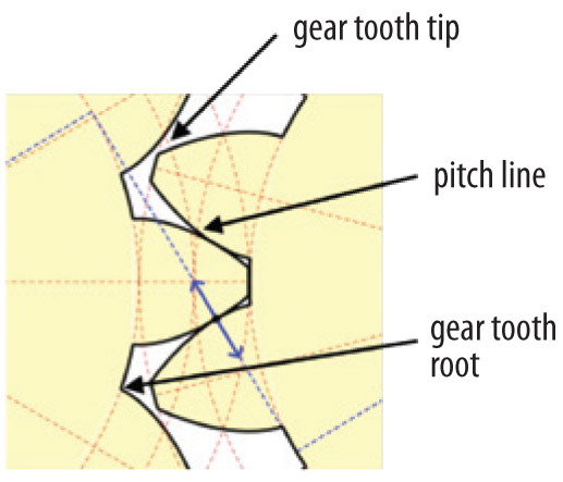

To illustrate this point, consider one of the simplest of all gear designs: a spur gear with involute gear tooth profile (Figure 1). For the sake of discussion, we can consider two points of interaction between the meshing gear teeth: the tip to root contact and the pitch line contact.
Part 1Part 1
Figure 1: Meshing spur gears with involute gear tooth profile
In an involute spur gear design, such as that shown in Figure 1, the contact at the pitch line on each gear set is almost exclusively rolling friction. Rolling friction is defined by two surfaces that approach each other in a perpendicular direction (Figure 2a). Under rolling contact conditions, separation between the moving surfaces will depend on the applied load and speed. At higher speeds, the increased pressure on the lubricant under load causes a rapid increase in viscosity of the fluid. With sufficient pressure, the lubricant can undergo an instantaneous phase change from liquid to solid, which, in turn, can result in an elastic deformation of the mating machine surfaces. Elastic surface deformation results in the load being dissipated across a larger surface area, allowing the gears to transmit the applied load without mechanical wear as the surfaces are separated by a full oil film. This is an effect referred to as elasto-hydrodynamic lubrication (EHL). The key to effective elastohydrodynamic lubrication is having a lubricant with sufficient viscosity and a high viscosity pressure coefficient. Having too low a viscosity or poor viscosity pressure coefficient can result in metal-to-metal contact, dramatically reducing the life expectancy of the gears.

Figures 2a and 2b: Rolling and sliding contact between two friction surfaces
By contrast, at the tip to root of an involute gear tooth profile (Figure 1) and in many other gear geometries, sliding friction is the dominant frictional force. Sliding friction involves surface motion in a parallel direction (Figure 2b). In high speed gearing, the speed relative to the load is typically high enough that moving surfaces are separated by a full film of oil. However, unlike rolling friction where elastohydrodynamic lubrication is the norm, high speed sliding friction results in hydrodynamic separation between the moving surfaces, an effect akin to a water skier experiencing "lift" once the tow boat speed is high enough for the applied load (weight of the skier and water ski dimensions). Hydrodynamic lubrication requires the oil to have sufficient viscosity for the applied load and speed, both of which have an impact on oil film thickness.
For slower turning gears, such as the low speed gear in a gear reducer, the viscosity of oil necessary for hydrodynamic lift is too high compared to the ability of the oil to flow into the load zone. As a result, a hydrodynamic oil film cannot be maintained and, once again, boundary lubrication conditions dominate. Where boundary lubrication occurs in conjunction with sliding motion, severe sliding wear - sometimes referred to as adhesive wear, galling, or scuffing - can occur. In an involute gear geometry, this typically occurs just above and below the pitch line and frictional forces transition from pure rolling to sliding friction.
Sliding motion also results in higher localized temperatures, which causes a reduction in the oil's viscosity and can also cause the oil to be wiped away from the converging gear surfaces, further inhibiting the formation of an oil film. Under these circumstances, the meshing gears will be under boundary lubrication conditions. Where boundary lubrication is anticipated, special wear prevention additives must be used to protect gear teeth.
