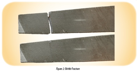

Brittle Overload Fracture occurs when there is little or no distortion of the part before it breaks. The file pieces in Figure 2 could be put back together in perfect alignment.
Figure 2: Brittle Fracture
Brittle fracture results from the application of excessive force to a part that does not have the ability to deform plastically before breaking. When a brittle fracture occurs, there is little warning. A high strength bolt breaks suddenly, a glass shatters when it hits the floor, or a cast iron bracket breaks without noticeable bending are examples of brittle fractures.
