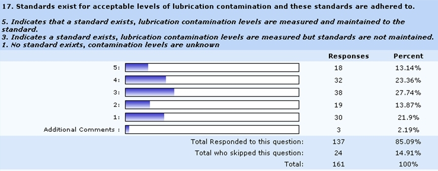

2. Start testing the condition of your lubricants and develop contamination standards and stick to them.
Over 60% of respondents did not maintain their lubrication to a defined standard. Over a third of these had no contamination standard at all. The long-term viability of your rotating equipment is heavily dependant of the condition of the lubricant. Lubrication contamination testing is relatively inexpensive, so while things are quiet, set up a monitoring schedule and build a relationship with a lube lab that will be able to guide you in setting acceptable standards.
StandardsStandards
