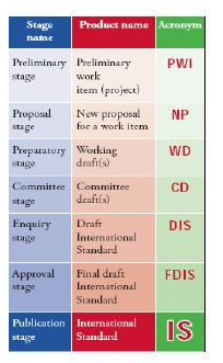

The three-year program takes us through a number of stages shown in the diagram. We are currently in the middle of the preparatory stage and have recently circulated the second set of working drafts around the committee members, with a view to having detailed comments returned in time for our next meeting in Arlington, VA in October this year.
Our plans are to enter the committee stage shortly after our Arlington meeting. Currently we are running on schedule, and as this continues we expect publication of our three standards in the first quarter of 2014
