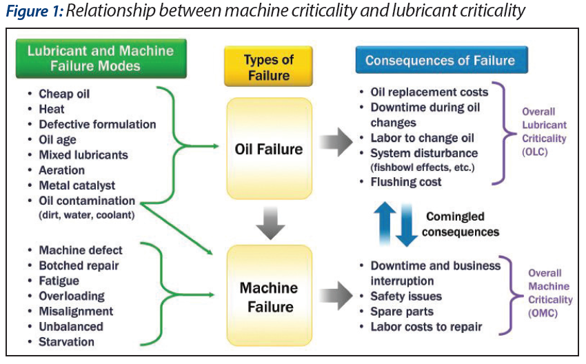

Figure 1 shows the relationship between machine and lubricant failure. On the left are common causes (failure modes) of lubricant failure and machine failure. For example, heat, aeration and contaminants are known to be highly destructive to lubricants. In a similar sense, overloading, misalignment and contamination can abruptly cause a machine to fail. Note how contamination not only can fail a lubricant, but also a machine directly without the need to harm the lubricant first.
It is best to not only list failure causes, but also to rank them in terms of probability and severity. This helps allocate resources by priority. From lubricant and machine failures come specific consequences, which are listed on the right in Figure 1. Again, these consequences are mutually exclusive. Lubricant failure consequences include oil replacement costs, downtime during the oil change, labor to change the oil and flushing costs. Machine failure consequences relate to safety, spare parts, labor to repair and downtime (e.g., production losses).
The overall lubricant criticality (OLC) defines the importance of lubricant health and longevity as influenced by the probability of premature lubricant failure and the likely consequences for both the lubricant and the machine. The overall machine criticality (OMC) defines the likelihood and consequences of machine failure alone. Like many methods, the approach for calculating OLC and OMC is not an exact science, but, nevertheless, is grounded in solid principles in applied tribology and machine reliability.
