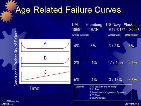

Studies by F. Stanley Nowlan and Howard F. Heap ultimately resulted in the creation of reliability-centered maintenance (RCM), which contains six charts, three now commonly labeled age-related failure curves and three commonly labeled random failure curves. These are provided in Figures 1 and 2 and contain the original data, along with data from other subsequent studies analyzing these failure patterns and the percent of equipment exhibiting these patterns. This article examines these charts, with a particular focus to the random curves. It offers observations on these, along with suggestions for developing a strategy for avoiding failures and managing impending failures.
Figure 1: Conditional probability of failure – age related
Figure 2: Conditional probability of failure – random
First, these curves should not be considered as age related or random. They are all charts that reflect the conditional probability of failure and are all on some sort of timeline, so lumping them into those two categories may not be appropriate. For example, the random charts include the so-called infant mortality curve, which also makes up part of the bathtub curve, and it does indicate a higher risk of early life failure on a time line. Moreover, conditional probability of failure is constant for some period of time in five of the six curves and represents some 83 to 97 percent of the total equipment covered in the studies, depending on which study you select. A constant conditional probability of failure means that the probability of failure of any given machine in a set is equal to the probability of the failure of any other machine. More simply, it’s a random failure pattern, as shown in Figure 3. Any comments to the contrary are welcomed.
The conditional probability of failure curves can be confusing relative to how they are applied to the development of the correct maintenance strategy for a specific part or component. The human element could play a big difference in how a part or component fails. As an example, if you misalign a bearing, it increases the load and the bearing could appear to be a pattern C failure. If you forget to lubricate, it will appear to be a pattern F failure. As such, the distributions represent how a component will fail if it is properly designed, installed and maintained.
