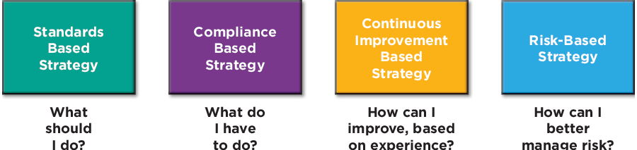

Figure 1: The four key strategies of (safety) asset management (Source: American Institute of Chemical Engineers)
