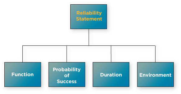

Reliability is the probability of a product successfully functioning as expected for a specific duration within a specified environment. Figure 1 shows the four key elements to reliability: function, probability of success, duration and environment. Maintainability is a characteristic of design, assembly and installation that is the probability of restoration to normal operating state of failed equipment or systems within a specific timeframe, using specified repair techniques and procedures. Maintainability is related to reliability because when a product or system fails, there may be a process to restore the product or system to operating condition.

It is important to state the reliability goal so it includes all four elements of the reliability definition (e.g., a wireless router provides 802.1n connectivity with features specified in product requirements document HWR003, in a U.S. factory environment, with a 96 percent probability of still operating after five years of use).
