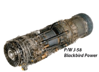

In November 2007, Dr. Robert B. Abernethy ("Dr. Bob") taught a 4-day Weibull Life Data Analysis class in Jacksonville, Florida. The instruction involved Weibull analysis and reliability growth management and analysis. Both of these are part of the International Electrotechnical Commission (IEC) publications. Outside of his reliability of life limited data analysis, Dr. Bob may not be known; however, Dr. Bob's 11 patents are very well known and were obtained when he was employed by Pratt & Whitney (P&W) as an engine designer. In the mid 1950's, the US Air Force and CIA approached Mr. Kelly Johnson (Lockheed Skunk Works), desiring a new aircraft that could fly very high and fast. This aircraft became known as the SR-71 Blackbird, and its power plant is the P&W J-58 that Dr. Bob and his team of engine designers and technicians developed. The SR-71 still holds all altitude and speed records for jet engines, and it has been 54+ years since the very first SR-71 flew.
