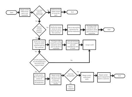

The salvage process:
When the part is determined to be unusable from the evaluation by the repair, the next step is to determine the best means to salvage the part. There are three decisions-having the repair center scrap the part at their facility, having the repair center send the part back to you for you to scrap, or having the part sent back to your salvage facility to break down the components to bring the most dollars in scrap value back to the plant. Each time, the dollar value of the part must be evaluated in order to make that decision. High dollar parts, with precious metals, need to be brought back to the salvage center and broken down into components. Once the part is scrapped, the buyer goes into the market to purchase new equipment and/or components. Safety stock and defined min/max points help to reduce the pressure of expediting parts to replace the original parts.
