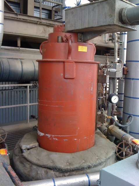

In 2010, AES Alamitos’ Units 3 & 4 boiler circulating pumps and Units 5 & 6 exciters were identified as having reliability issues. These machines were never equipped with vibration probes and only the metal temperatures of the exciter pedestal bearing and common lube oil drains were monitored by the control room recorders. Due to low cost of implementation and software compatibility, it was decided to purchase and install a monitoring system (see Figure 1) to improve the reliability of the AES Alamitos Units 3 & 4 boiler circulating pumps (see Figure 2) and the Units 5 & 6 exciters.

BOILER CIRCULATING PUMPS
The vertical boiler circulating pumps have a carbon coated bearing and seal that are cooled and lubricated with water. As the seal fails due to normal wear, it allows hot boiler water to enter the pump bearing, in turn causing it to fail (see Figure 3). The failure mode causes the pump’s upper bearing to have a subsynchronous vibration (see Table 1). In the past, the seal failure (see Figure 4) would go undetected until the motor’s liner, which separates the windings from the pump, ruptured. The rupture would ground the motor, causing a catastrophic motor failure. The repairs would take up to nine weeks at a cost of over $150,000 per pump/motor. With the new monitoring system, they can now detect an impending bearing seal failure at its earliest symptoms and shut down the pump/motor before it ruptures the Inconel liner. The pump can then be removed and the seal and bearing repaired in less than three weeks for a total cost of $30,000, a savings of about $120,000 per pump.

To date, AES Southland has successfully saved six boiler circulating pumps at Units 3 & 4, generating savings of over $100,000 each. In addition, it has identified two serious vibration problems on Units 5 & 6 exciters with preventive savings in the millions of dollars for each event. AES estimates a potential overall savings since 2010 of about $2.6 million on a capital outlay of under $75,000.00. Not a bad return on investment!
