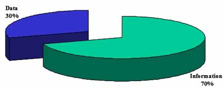

It has been the experience of the author that on commencing reliability initiatives most companies do so with a conservative estimate of 30% empirical data and 70% end-user knowledge. While this still leads to improvement, it is far from the high confidence risk based decisions required in today's asset management environment. Particularly with the scale of economic impact of getting it wrong, or where getting it wrong could significantly impact upon safety.
This is the central polemic issue relating to risk modelling. Companies, by themselves, rarely have the level of failure data required to perform accurate probabilistic analyses. Even if their failure capture technologies and processes were able to deliver the right quality of failure data, (and many organisations have overcome this hurdle) they need to have a large number of asset failures before they can produce high confidence probability models.
