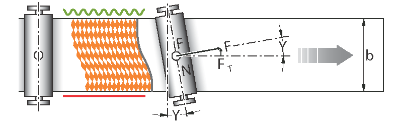

In the paper industry, for example, enclosures, such as the drying hood, represent an optical barrier for the theodolite bar. Large distances between rolls in galvanization lines make the usage of telescope bars impossible. However, roll alignment is absolutely necessary. Figure 1 shows the effects of a nonparallel roll on the material web.
part2part2
Figure 1: Effect of a nonparallel roll on the material web where a transversal force orthogonal to the production direction occurs. Whatever this force may do to the web, the consequences are negative for production output and quality. They may reach from small folds to web breaks and increased web movement. Furthermore, the web extension is nonsymmetrical (illustrated by the red line for higher tension and the green waves for lower tension), which leads to a nonsymmetrical winding of the web. Last but not least, the material itself is deformed, as shown by the orange rhombuses.
The transversal force caused by the misaligned roll stretches the web nonsymmetrically, deforms it and makes it move up, which results in the production of folds and web breaks. To prevent such a scenario, the rolls have to be aligned orthogonally to the machine’s reference line and parallel to each other. As previously noted, this can be a challenging task.

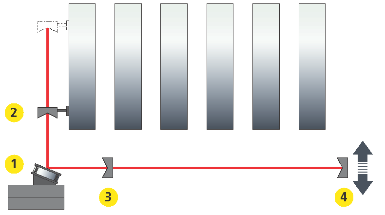

Figure 2: Determination of roll parallelism using traditional technology. A laser beam is set up alongside the machine axis and then deflected into the rolls to be measured. If the rolls are to be checked on separate levels or in housed areas, this measurement procedure is time consuming and the use of additional optical equipment in order to reach each roll represents a loss in accuracy.
In theory, after the machine’s axis has been picked up from reference marks 3 and 4 shown in Figure 2, the laser beam is deflected into the machine to measure the position of a roll. Therefore, a detector must first be placed on the operator’s side and then on the machine’s side. This process has to be repeated for every single roll, which makes it very time consuming.
In real life, machines can reach from the basement of a factory over several floors to the very top. In most cases, no optical access is available. In such cases, telescope bars can help align one roll to the next. Circumference measurements are also a possibility, but only if the distance between the rolls is not too high.
