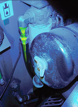

Featuring a portable, high-intensity blue light (450 nm) LED flashlight, when used in conjunction with the company’s revolutionary FluidSafe™ fluorescent additive, the SB-450 kit is successful in pinpointing the smallest fluid leaks in hydraulic system hoses, fittings, seals and other components. This allows tiny leaks to be repaired before they lead to big, catastrophic failures. Not only can SafetyBlu help prevent the unexpected, it can lower anticipated operating costs by reducing hydraulic fluid consumption…up to 7% of your total annual hydraulic fluid budget.
When added to the reservoirs of hydraulic machinery, FluidSafe aids in the detection and surgical removal of hydraulic fluid in the event of an accidental fluid injection that penetrates the skin. That’s because when viewed under the SafetyBlu lamp’s high-intensity blue light, the additive’s bright green fluorescent glow pinpoints the injection track quickly and accurately.
