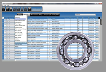

Rolling element bearings generate vibration frequencies that are governed primarily by bearing geometry. As bearing faults develop, monitoring of the frequency bands that coincide with specific bearing components allows more sensitive monitoring and earlier advanced warning to facilitate maintenance. It also gives insight into root cause of the bearing failure, such as machinery misalignment or unbalance, bearing lubricant breakdown, running hours in excess of L10 life, pitting, spalling, electrostatic discharge, or other causes.
When a channel in the SETPOINT System’s Universal Monitoring Module (UMM) is configured for enveloped acceleration, it now returns the following seven parameters:
  • Overall acceleration amplitude
  • Enveloped acceleration amplitude, filtered to Outer Race Ball Pass (ORBP) frequency
  • Enveloped acceleration amplitude, filtered to Inner Race Ball Pass (IRBP) frequency
  • Enveloped acceleration amplitude, filtered to Cage frequency (also known as Fundamental Train Frequency or FTF)
  • Enveloped acceleration amplitude, filtered to Ball Spin frequency
  • Enveloped acceleration amplitude, filtered to 2X Ball Spin frequency
  • Sensor bias voltage
Using bearing tables for the particular bearing geometry, bandpass filter corners for each of the above parameters can be set. Alarms can also be set independently for each parameter. Users can then alarm and trend the vibration levels within these frequency bands for a sophisticated and effective monitoring strategy.
