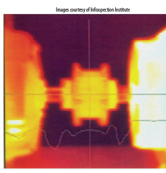

In late 1993, Infraspection Institute in New Jersey demonstrated in a carefully controlled study conducted at Miller Brewing Company that misalignment generates heat and wastes energy. This was clearly demonstrated in the comparative infrared signatures obtained on the same machines when running in an aligned and misaligned condition with deferent types of couplings (see Figures 1 and 2.) Precise magnitudes of misalignment were very carefully set with an Optalign® laser system and the results meticulously examined with calibrated thermograms recorded for each case.

Figure 1: Falk Grid Coupling - Left: Aligned, Right: Misaligned
Images courtesy of Infraspection Institute

Figure 2: Dodge Coupling: misaligned
Image courtesy of Infraspection Institute
In Figure 2, we see Infraspection Institute's infrared thermogram from the Miller study for a misaligned Dodge "rubber donut" type coupling. It clearly shows that the energy wasted in overcoming the forces produced by misalignment is significant. It should be noted that some of the heating of the motor on the right can be attributed to the axial force imposed on the bearings by the centripetal forces acting on the coupling, which tend to thin the coupling and pull the shafts inwards.
