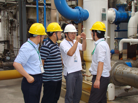

SKF Linde TeamSKF Linde Team
So the Nanjing plant (joint venture with Sinopec SPC) was the first plant selected for a pilot application of a predicitive maintenance programme (PdM). Before running the pilot application Linde invited specialist companies, including local Chinese suppliers, to do some PdM service work at the Nanjing plant and propose a long term program along with details of the services provided and the costs and anticipated benefits to Linde. After one year of trials and discussions with the competing vendors Linde selected SKF to start up the PdM activity for their operations in China. When asked about the reasons for their choice Aung-Kyi said 'a number of key points separated SKF from the other vendors. As well as providing excellent services in the actual monitoring of the plant they showed their experience by identifying what equipment to monitor and went on to produce work recommendations that were far broader than the other vendors. Naturally, the local Chinese vendors had a price advantage, even though the SKF people are from the local SKF China organization, but from SKF we got more than just a ‘condition report'. We got constructive feedback of a depth that local suppliers could not match and a feeling that they really knew the machinery under investigation and had as much desire as Linde to manage that equipment efficiently. And that transmitted a huge amount of confidence to the local Linde engineers, which is really needed to get PdM understood and implemented properly. It wasn't enough that I was satisfied with a particular vendor. What was really important was that the plant engineers in Nanjing wanted the vendor, and effectively it was joint decision by myself and the actual Linde people receiving the service, to select SKF. In addition I knew we were embarking on a period of growth and that we would need an experienced and stable supplier that could support us as we grew, so I was very happy to select SKF who are also a global vendor with a large and also growing presence in China'.
