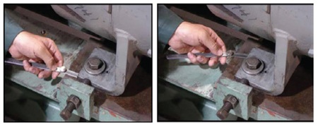

The question is, Where is the problem? Is it the foot or the base? We use the term soft foot to describe foot problems, but this is incorrect. The word is actually a description of the feeling you get when you are tightening a machine's foot. Although the foot appears to be down, you can still tighten it and pull it down some more. It feels soft or spongy. If you feel this, the foot is distorted and flexing as you tighten it. To find and correct this problem, we can quite easily measure it with a feeler gauge (Figure 2).
Stress Article ImageStress Article Image
Figure 2
We have to make sure we measure under each corner of the foot so we can make the proper correction. We can do this as a rough measurement with the bolts loose and then tighten them and redo each foot tightening and loosening.
