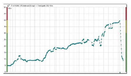

Using a real case example from the twin wire press application, Figure 1 is an account of the different stages of the bearing deterioration process, detected with the SPM HD method.
Uptime Article Fig 1Uptime Article Fig 1
Above: An SPM HD trend spanning between mid-June, 2010 to end of November, 2010, showing 624 readings taken approximately 6 hours apart. The graph shows the primary parameter produced by the SPM HD method: the strongest impact found during the measuring time. The Y scale is logarithmic.
The difference between the lowest and the highest value in the trend graph is about 30 dB (30 times on a linear scale). The drop in the value from 40 dB to 8 dB is after bearing replacement. A moving average filter has been applied with 10 average values. This explains why the values seem to decrease slowly after the replacement. Note the typical pattern of increasing values followed by a period of decreasing values. This behavior is caused by fresh spalling followed by a period of mechanical softening of the sharp edges around the spall. When the rolling elements collide with the sharp edges of the spall, strong elastic waves will be generated at the point of collision. After some period of time (a couple of weeks in this application) the sharp edges wear down and the metal-to-metal collisions become less strong, hence decreasing the strength of the elastic waves. The next spall will then generate a similar pattern.
