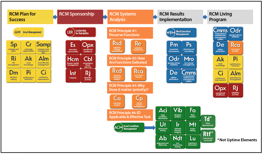

Figure 1 summarizes how an RCM program is carried out using the Uptime ® Elements framework. At the start, significant steps to plan for success must be taken and then immediately followed up with RCM sponsorship steps to ensure stakeholder support. Proper RCM systems analysis training must also take place to ensure informed implementation of the RCM process.
“RCM implementation must be strategic for it to succeed and be sustainable.”
After completion of an analysis, RCM results implementation must proceed to the step that may defer and cause project failure: implementing results in the computerized maintenance management system. Finally, an RCM living program is put in place to periodically update RCM decisions as the plant and technology change.
Figure 1: Implementing RCM using the Uptime\u00ae Elements framework
Figure 1: Implementing RCM using the Uptime® Elements framework
RCM Plan for Success
Benjamin Franklin famously said, “If you fail to plan, you are planning to fail.” While planning does not guarantee success, it does serve as a road map for understanding the overall objective and direction of a project. There must be a clear understanding of the strategic plan (Sp), achieved by creating an asset management (AM) policy that defines risk management within an operating context. The AM category of the Uptime ® Elements includes developing a strategic asset management plan (Samp) and translating the requirements of stakeholders to a lower-level document that defines the strategy for bringing together asset knowledge (Ak), risk management (Ri) and other aspects in the AM category. The Samp document should define how RCM fits into the overall reliability strategy.

RCM Sponsorship
Executive sponsorship is critical to sustaining any RCM program. The leadership for reliability (LER) elements include executive sponsorship (Es), which ensures the RCM project is funded and has a leader to oversee the team. The leader ensures risk management is not decided simply off a predetermined template, but rather based on the plant’s operating context.

RCM Systems Analysis
At this point, the team is prepared to execute RCM systems analysis. RCM follows many of the elements found in the reliability engineering for maintenance (REM) category. Ideally, RCM is best performed during the design phase using reliability-centered design (Rcd) and criticality analysis (Ca). Unfortunately, most of the time, the maintenance community is handed a design not of their own choosing and instead must do their best to maintain it in the best operating condition.
To select the most applicable and effective tasks, the team must understand the asset condition management (ACM) group of the Uptime ® Elements. Knowing when to use vibration analysis (Vib), ultrasound testing (Ut), or other ACM techniques is critical to making sound preventive maintenance (PM) decisions. The team should consult with an ACM expert to review their ACM decisions.

RCM Results Implementation
Once PM tasks are selected, a plan is put together to modify the existing PMs to RCM derived tasks. This involves the work execution management (WEM) category of the Uptime ® Elements. PM tasks are organized and packaged into work orders for efficient execution. Planning and scheduling (Ps) is required to effectively execute the new PMs.

RCM Living Program
Once the RCM results are implemented, an RCM living program is initiated. It is used to determine how well the results are performing. Are reactive actions being reduced? Were the appropriate PM frequencies chosen? Are performance indicators trending in the desired direction? These results are determined by tracking work using the Cmms. The living program is considered a continuous improvement (Ci) effort over the entire asset lifecycle (Alm). Looking for root causes of failure (Rca) and eliminating them is part of the reliability journey (Rj) toward operational excellence (Opx).
