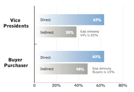

Asset intensive organizations often manage tens of thousands of items - spare parts, materials, equipment and supplies - to keep plants and facilities running. Procuring and storing this MRO inventory (indirect materials) is expensive, with large enterprises often maintaining tens of millions of dollars of inventory. A.T. Kearney's 2010 Indirect Procurement Study (http://www.atkearney.com) reports that indirect spending sometimes accounts for 50% of thirdparty spend in manufacturing organizations. Still, many organizations perceive direct materials to be more important, as reflected in relative perception (Figure 1) and procurement headcounts (Figure 2).

Figure 1 Source: MSC Industrial Supply Company - Strategic Opportunities for Indirect MRO Procurement
