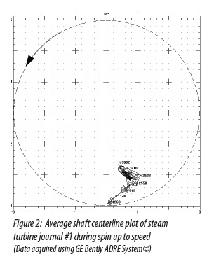

Normal measurement involves two radial proximity probes (X & Y) installed 90 degrees apart at each bearing. When the probe signals are plotted against each other, the result is the orbital path of the shaft centerline within the bearing clearance, as shown in Figure 1. The average shaft centerline position within the bearing clearance also can be measured as shown in Figure 2. Adding another probe to measure a once-per-revolution event, such as a keyway, provides valuable phase information. Data plotted in Bode format from the #1 journal of a steam turbine during spin up through a critical speed is shown in Figure 3.

Figure 2Figure 2

The shaft orbit and average shaft centerline position data are very useful to diagnose rotor dynamic problems, such as unbalance, misalignment, rotor rubs and bearing instability problems like oil whirl or oil whip.
