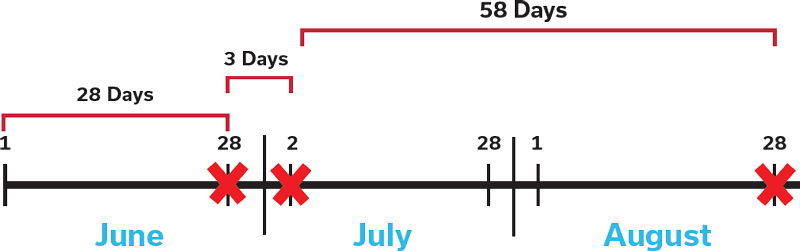

  • 30-day PM - Must be completed within three days or PM is “Out of Compliance”
  • “Out of Compliance” means more equipment failures and higher maintenance costs because of variation in execution
Figure 2.1: A simple rule: you cannot perform preventive maintenance that continues to break down; something is wrong.

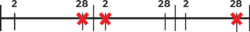

However, there is a solution to the PM compliance metric to make it believable and truly help you feel confident that it is a true measurement of compliance to your PM program. This solution, which has been tested and proven, requires you to manage your PM program as a controlled experiment. By doing so, you can control reliability with more reliable accuracy.
Now, in order to have a controlled experiment, you must control the variables, such as time. Most PMs are time based, therefore, controlling the variance in your PM schedule would allow you to control reliability better and help you make better decisions.
The 10% rule of preventive maintenance simply states that:
A time-based PM must be accomplished in ten percent of the time frequency or it is out of compliance.
Figure 2.2: This figure illustrates how many organizations perform a monthly (30-day) preventive maintenance strategy applied to a specific component.
